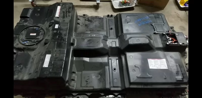

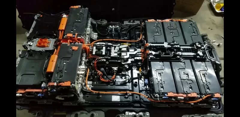

Thank you all for responding. The battery has what looks to be a plastic top with an o-ring seal. I think the photos are just a cutaway view and the battery must be under the vehicle (but at the same time it is under the seats in the photos.). I don't see this awkward/large component coming out the door or trunk (trunk has small pass thru, the advisor may have confused this model with the insite/accord hybrid with the small battery?)
You can see the complete battery inside and out on youtube ( 2018 Honda Clarity hybrid lithium ion battery disassemble Part 1/2).
