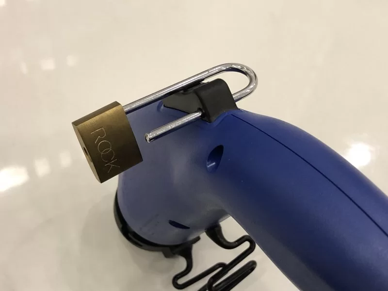

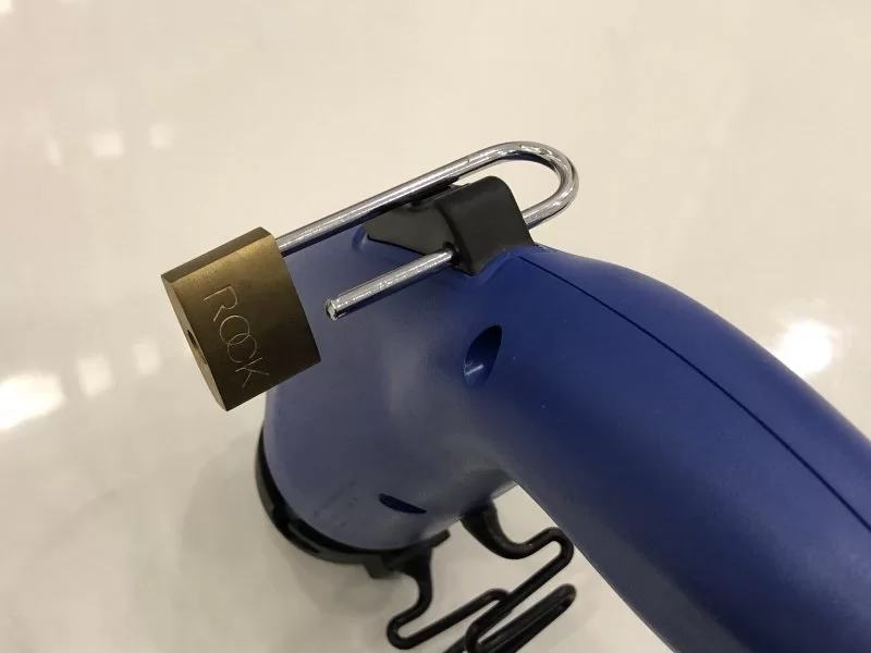

There's a hole in the charger release switch that looks like it is designed to accept a small luggage style padlock that will elegantly keep the charger connected to your car to prevent simple walk-away theft. After a padlock is fed through, the release is jammed held in the lock position. This is what I'll use if we charge 110V publically.
This is what I do as well... it will at least prevent an opportunistic theft.
