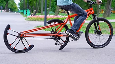

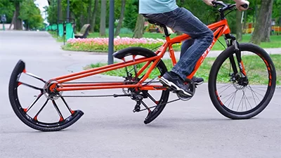

Here's someone with too much time on their hands proving a half-wheel (well, a pair of half-wheels) can work:
Anything can work in photoshop.
Presumably those are solid tires as no valve stem is present on the rear wheel. There could be one hidden on the middle wheel behind the chain stay or seat stay. Using pneumatic tires would be a challenge. The single derailleur on the middle cassette isn’t going to keep the chain on the same cog on the rear cassette. That would create an unpleasant pedaling experience. There’s no caliper on the rear disc. And uneven terrain could be problematic.
There may be other design flaws that are yet to be noted.
I included a link to the video--the half-wheel bike is not a Photoshop fake. He made a "bike" with 3 partial front wheels, too.
