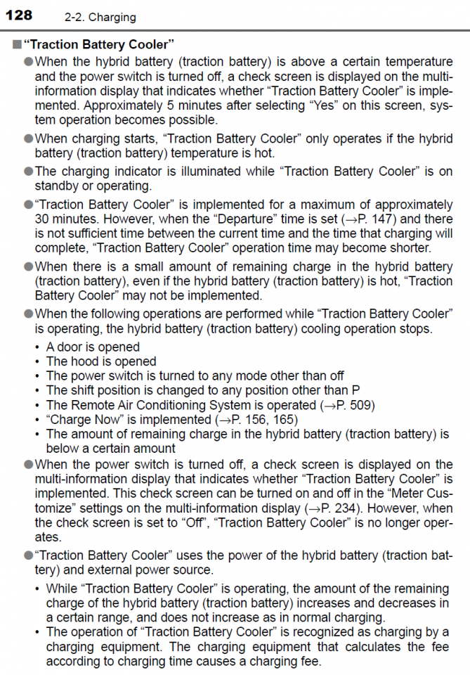

the Prius uses the Air conditioning from the passenger compartment and pulls it with a fan in the back seat to blow over the battery in the rear trunk area. I'm not sure how they cool the prius prime with the larger battery. On line everyone thinks the Prime is the same design with just air vents. see below.
