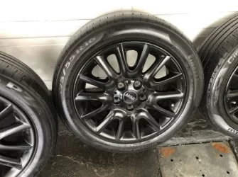

I found a nice-looking set of wheels with run-flat Pirellis on Kijiji (what used to be eBay Classifieds), called the seller, agreed on a really good price, and ran to get them. I found out on this forum they are 495 Victory Spokes, and while they were quite dirty, they looked to be in pretty good nick.
As they appeared in the ad.

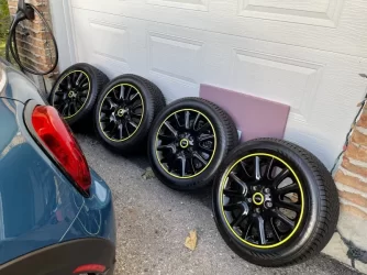

Let’s pop in the SE center caps!
Ooh looks good. But I’d like the wheels to stand out a bit more. Hmmm…
I thought about some sort of protector like RimBlades or AlloyGators, but could not justify the expense, and was a bit concerned that I wouldn’t find the their yellows to match with ours after spending all that money. Instead, I chose to go with a pinstripe. I found that Oracal 651 “Brimstone Yellow” vinyl is a very close match to our Energetic Yellow trim, and ordered a roll of ¼” striping tape. I have a cool striping tool for wheels, which makes quick work of it. Enjoy this quick, raw video I took today.
Last but not least, I finished by coating the tires with Tuf-Shine Tire Clearcoat. It is by far the best tire coating product I’ve used, and gives amazing results —customizable from subtle satin sheen to full gloss — that last months, not weeks.
The final result looks pretty great IMO!
