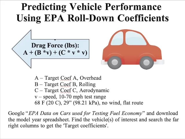

Comparing EPA metrics for electric vehicles (EV) can be confusing. The EPA can publish 5-test metrics, 2-test metrics with an 'engineering factor', and/or manufacturer sandbagged value. For example, Tesla reports the 5-test metrics, the same as ICE and hybrid cars use, and is often criticized for 'too rosy' range. Fortunately, the EPA mandated, roll-down coefficients provide a single approach for head-to-head comparisons.
The roll-down coefficients measure the drag force as a function of speed:

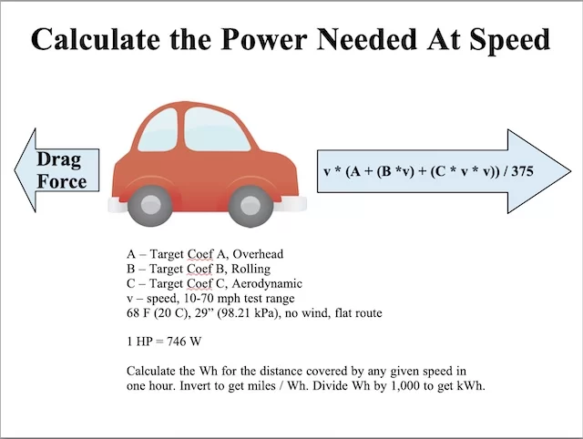

The vehicle must supply an equal amount of thrust, the power, to maintain a constant speed:

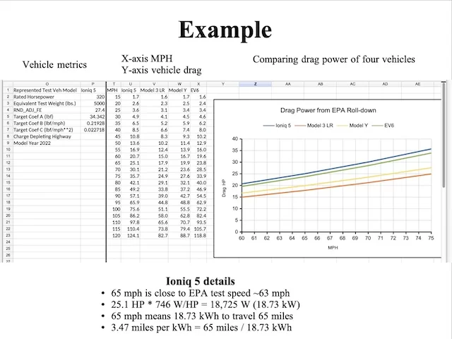

So here is an example of a spreadsheet comparing four EVs:
This universal approach unifies EV performance across vehicles. Combined with the usable or available battery kWh, one can accurately predict range and electric operating costs. Yet is also works with ICE and hybrids.
The operating line and thermodynamic efficiency predicts the fuel consumption at any given speed. For example, the Toyota hybrid transmissions are very good about keeping the engine at peak thermodynamic range and banking or drawing excess power from the traction battery. So I've attached a ZIP file with both this OpenOffice presentation and spreadsheet which you can play with.
