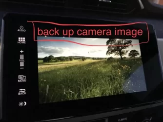

Had the usual preconditioning/ SiriusXM lock out so I reset the radio by pressing the power button and holding. As it rebooted, I made a right turn, activating the side view camera, and the screen stuck on the screensaver photo with a small window at the top showing the backup camera. That lasted about a minute and then the BU camera went black and the screensaver remained and was unresponsive to touch, except I could choose audio inputs via the steering wheel.
The resolution was to turn car off and allow it to completely power down, restarted and it works fine.
