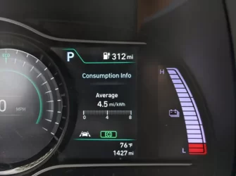

My Kona is 3 months old located in New York State 75 miles north from NYC Picture taken July 10 2019 outside temp 88 F garage kept with temperature 75 F
