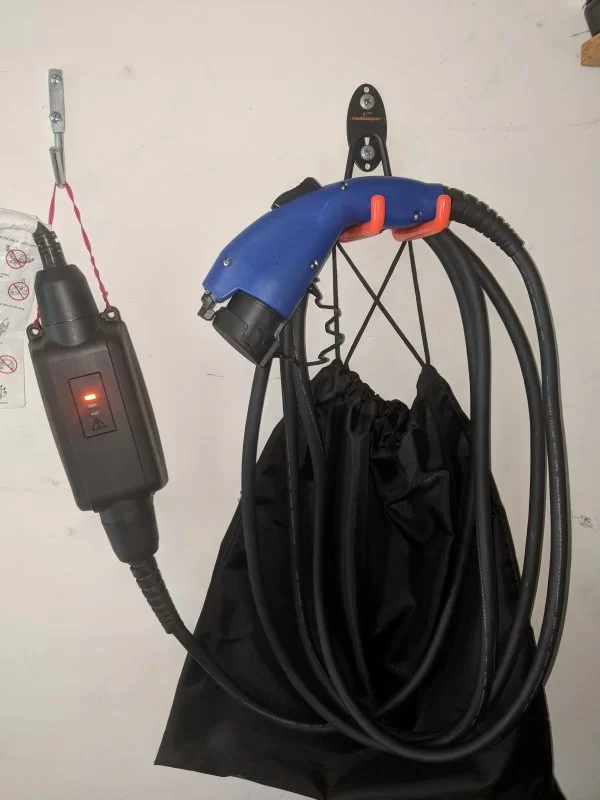

laptop
One of many, many ways to mount/support.
Hope this helps.

Thanks everyone, what I am looking for is rather an angled power cord and I do hang the other portion, most of the time.
Sent from my Nokia N73
In another thread it was suggested to use a bungie cord through the two eyelets, to make a much larger loop which can then be easily hung from normal sized hooks.
I just wish I had thought of it before seeing it here. I've been struggling with small headless nails.
