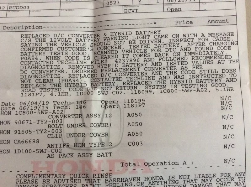

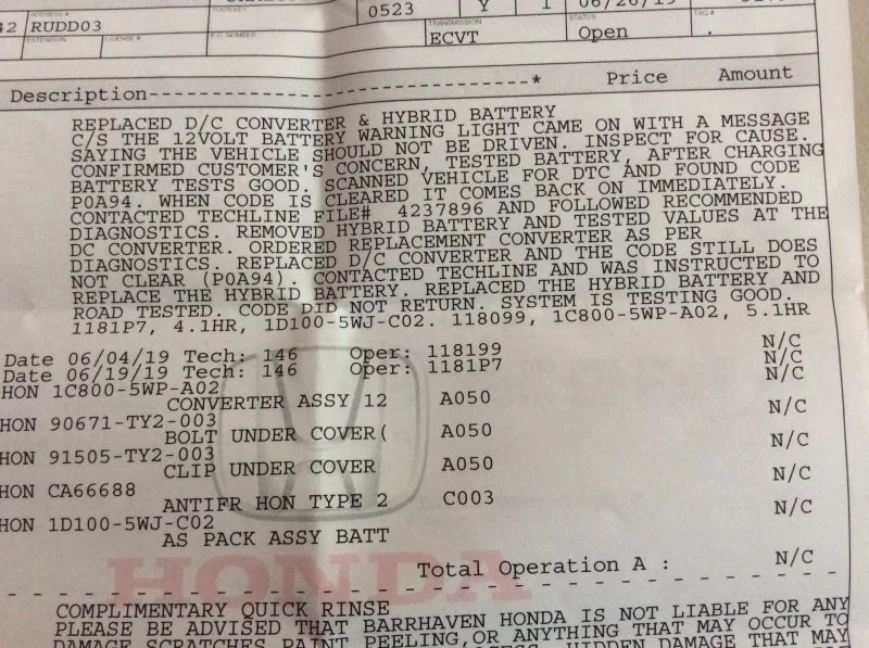

They told you (apparently based on the codes) that they needed a diagnostic tool which they had to order and it would take two weeks to get it (presumably coming from Japan).
Response:
Yes but that was never confirmed and there is no mention of this in the service report so it is possible that was bs or I misunderstood (photo attached).

Did they indicate that they now believe that your original DC converter was okay and that the problem was almost certainly in the battery?
See the photo. It was replaced and the code persisted so I have to assume that was not the problem.
