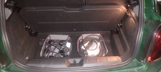

My J1772 Tesla kit lives under the boot floor. I feel that it is more useful there than at home... I can use it to charge at up to 7.2kW. Adaptors for 5-15, 5-20, 6-15, 6-20, 6-50, 10-30, 14-30, 14-50, CS8365C.
I also have an as yet untested Chinese Tesla adaptor. I should add a TT-30, an extension cord and maybe a tow rope.
