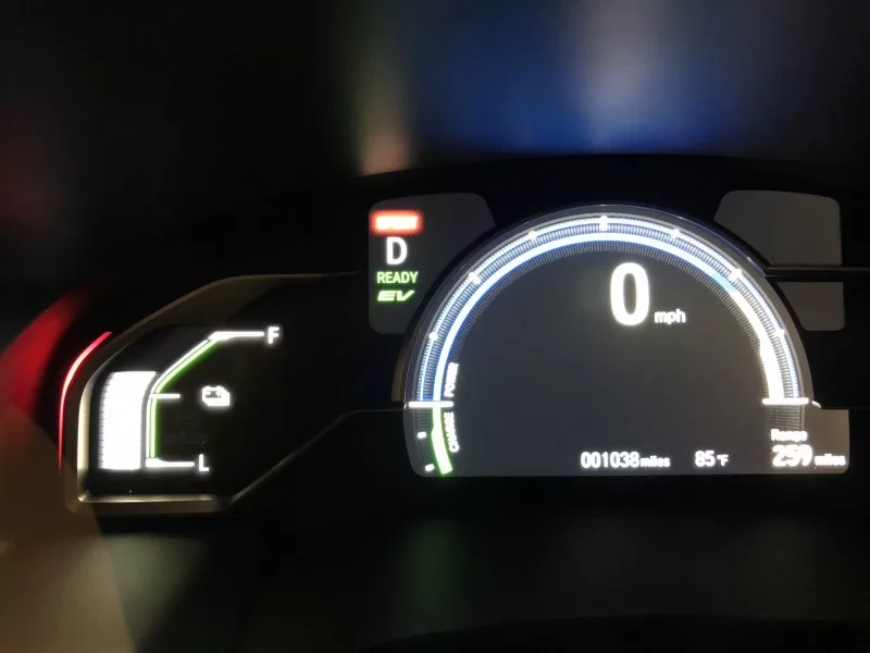

Slightly off topic but responding to the above comment from M.M. In my case, the length of the Blue solid line is same (far right) for both Econ and Sport mode (picture attached). I drive in Sport mode all the time and I'm always able to keep the car in the EV mode even when I accelerate fast. Do you all have a shorter blue solid line in Sport mode?
Also, yesterday the ICE started for no reason whatsoever, at full charge in Econ mode and the solid blue line turned to a dashed white line and the power flow monitor showed power being drawn from the ICE. The EV indicator turned off. I continued to drive (HV range dropped by a few miles) but after 5 minutes the EV indicator came back on and the power flow monitor showed the car drawing power from the battery. However, the solid blue line never returned and the gauge continued to display the dashed line all the way for the entire 180 degrees.
The whole system needs to be re-tested and fixed by Honda as it's not very stable/consistent.
