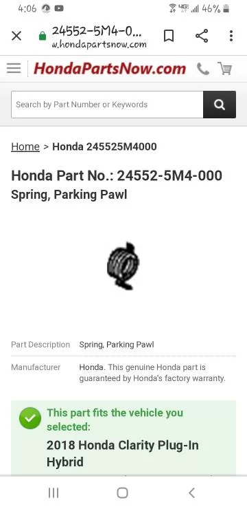

Well yeah manual trannies don't have "Park" so when I said "When any car is placed into park" I meant automatic. Parking pawls on automatics (non-manual in this context) are government mandated, or at least having a mechanism to hold a car on an incline, not engage except at stop or low speed, and meet a requirement for the amount of rollback. Manuals are exempt I suppose since you can effectively do the same thing by leaving it in gear (although we all know how that goes sometimes). As far as I know all automatics including electric cars have a parking pawl, the only exception seems to be Tesla. The Roadster apparently had one but then they came up with a brake caliper that will hold even with loss of electricity and hydraulics so that seems to meet the requirement. Whether Honda does something similar would be interesting to know but I'm guessing they just stuck with the more mundane parking pawl, which they just need an output shaft to install it on.This refers to “any car” as long as the car has an automatic transmission. Manual shift cars don’t have a parking pawl. I’m quite certain neither does the Clarity.
I find it unlikely the Clarity has a parking pawl since it lacks a transmission.
I have not yet disassembled mine to confirm.
