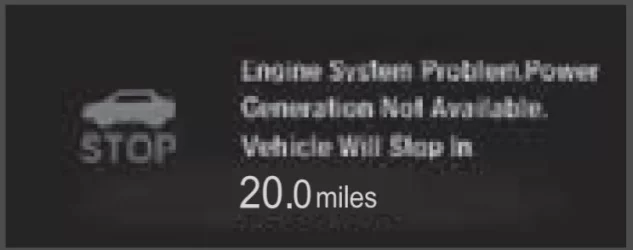

I was running in HV Mode, 28 miles Of indicated battery range left, trying to stretch to the gas station. The gas range was at zero (?!) for at least ten miles, though the engine never coughed. The car was running fine on battery so I didn’t think to switch to Eco mode.

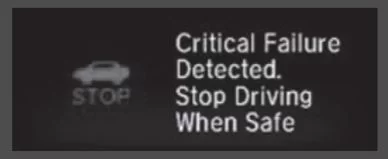

As I exited the ramp, a big red warning came on the center console: “Critical Error. Stop your car safely and turn it off”, or something similar. I held my breath, as the beeping continued, but the car was running under power.
Rolled to the gas pump, pushed the “Start” (On/Off?) button, realized I had been holding my breath. Filled the car—7.1 gallons. Guess it was indeed empty.
Waited a minute, pushed Start. No more error. Selected HV mode, engine started without a cough; guess the injectors didn’t run dry, or this design fixed that problem. Completed my next hundred miles of driving, no further incidents.
