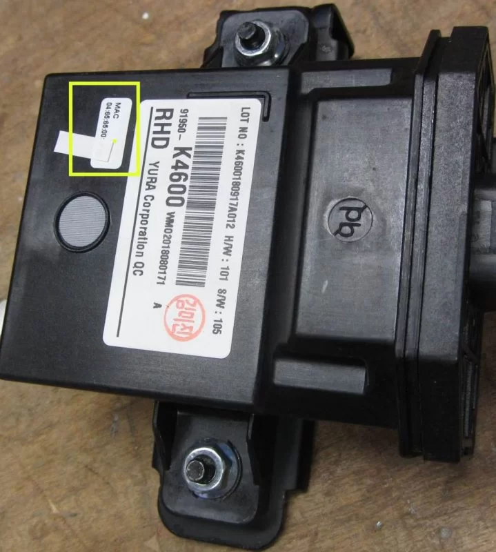

And yes, I can confirm that the Kona does have a MAC address in the CCS charge controller

And yes, I can confirm that the Kona does have a MAC address in the CCS charge controller View attachment 9959
Where exactly is this charge controller module located on the car?
Just curious.

Above the steering column, on the firewall. Needs the "sit upside down in drivers seat" position to access. (This is for my RHD, the LHD version may be differrent - the unit has a different part number for LHD)
Thanks, I will check out my unit and location as well (when my back allows me);)
