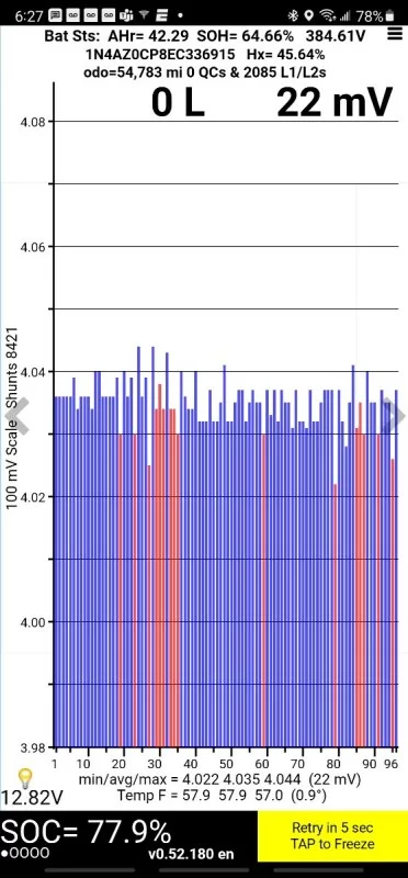

I am planning to buy my first electric car - a used 2014 Nissan leaf. I test drove it, but have some concerns about the state of health.
Here is the leaf spy screenshot.
The owner mentioned that it gets 50 miles in a single charge. How fast will the battery degrade ?
My daily commute is 42 miles round trip, so I am a bit on the fence to buy this.
How many miles will it loose over say 10000 miles.
The mileage is 55000 miles, and the owner is asking for 6500 US $.
Wanted to get opinions from existing leaf / ev owners on this purchase.
