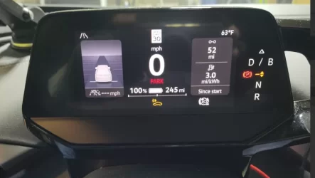

Heres what the error warning looks like on the screen

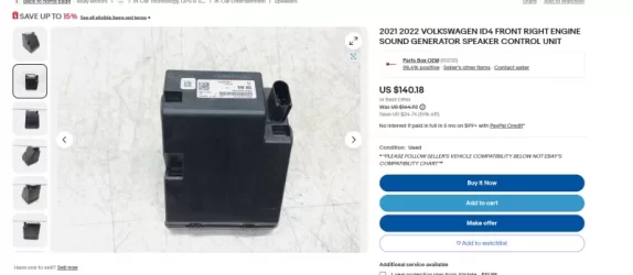

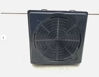

back to actually helping drivers tht run into this issue.. Here is what the Module looks like and what you can expect to pay after your warranty runs out..so you see they are cheap. and you can see just plug and play. I think 3 bolts to the bracket and thats it.

Just installed it. I actually asked the tech if he coud wrap the electrical plug but he said that wasnt the issue the plugs are already sealed and water most likely came in from the speaker holes.
Much like the Kona EV the ID 4 module is also in the front and covered with the the plastic/rubber protective sheild that runs from fron to the back of the car. looked like Water coming from wheel well area . Just shorted it out. The high pressure underbody wash pretty strong. anyway just good to know it is a easy cheap fix.
BTW.. what happens is you first get the warning light inside and a message ..paraphrasing ..that the electrical sound generater not working , that you can still drive the vehicle but take extra caustion at intersections
Problem is that you get a warning Chime inside the vehicle that goes off every minute .very annoying . You cant put up with that for days or even weeks until dealer can get the part and installed. So just unplug it.
The error remains on the screen but you no longer get the annoying chime.
