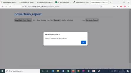

Once again, thank you MrFixit! I was able to generate a report today, and then use it to update my numbers in the spreadsheet. Firefox kept giving me an error (see attached file), but Chrome worked.
Thanks for pointing this out. I thought I tested Firefox, but apparently not.

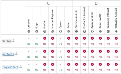

The Web Serial API is not [yet] compatible with Firefox.
You can use Firefox to read an existing log file and generate a report. It just can't Load 'Data from Clarity'
Here is a table showing current browser compatibility of Web Serial:
Bottom line is stick with Chrome, Edge, or Opera. I would really like to see this API grow to support cell phones, but right now it is only these three browsers on a PC.
