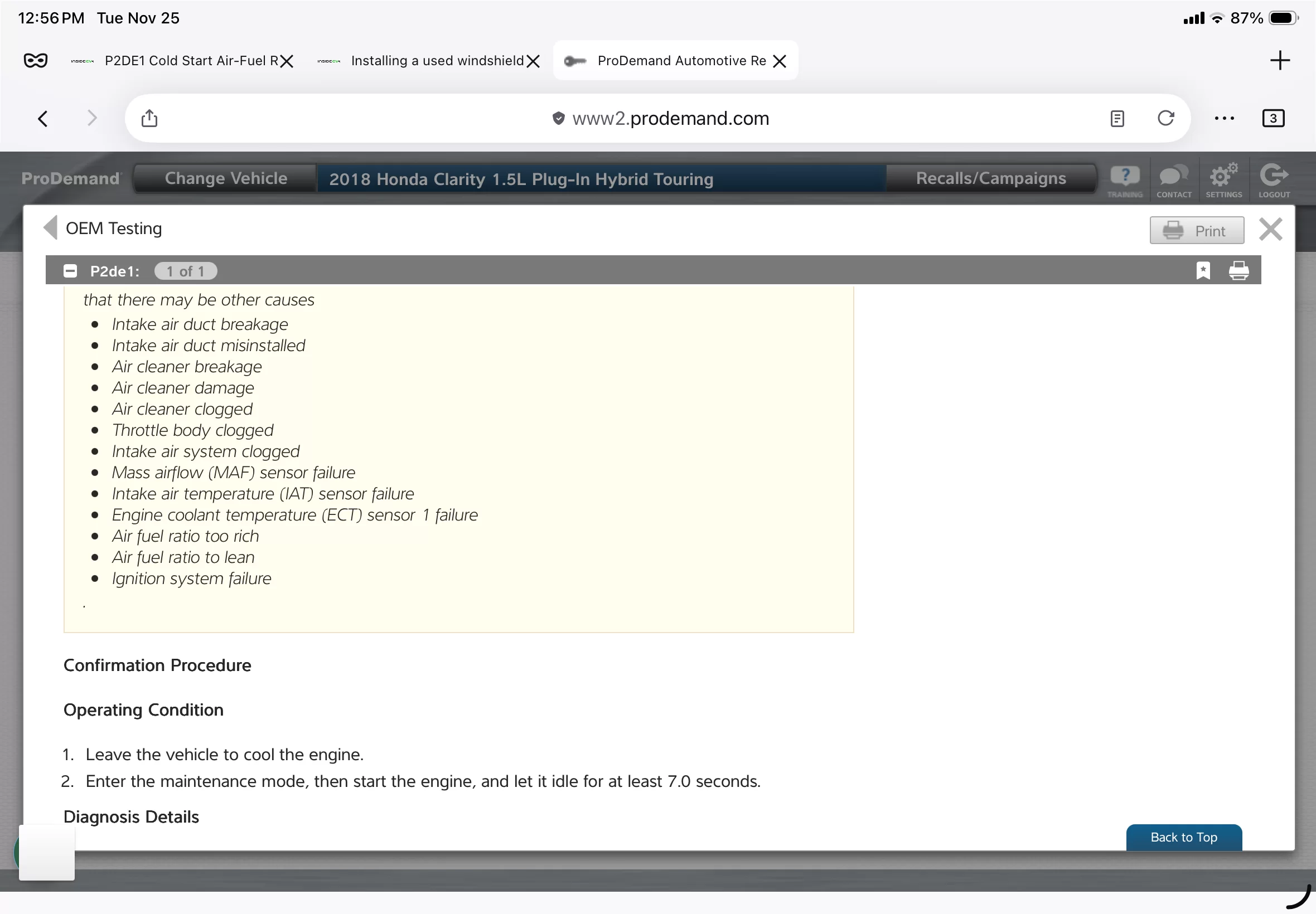

Cleared the stored DTC to see if it comes back or if the permanent DTC will go away. Would it make sense to examine the throttle body? Any other troubleshooting ideas or suggestions? Thanks.
