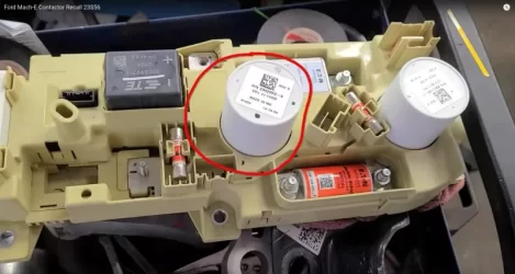

I looked at these parts that were failing. They look very weak, it was a clear design error. However, this did not fix the physical problems that led to this recall. This was as a consequence of the electrodynamic recoil force when the current is rapidly increased.
There is simply no current in the car now that will throw off the contacts in the new parts.
