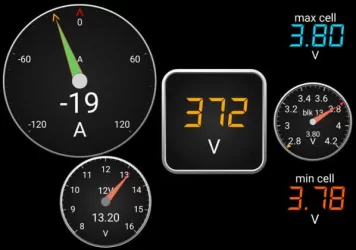

That aside, I can use the obdlink app to set up custom PIDs after all. [Torque
Lite has a config menu to create custom PIDs and it even saves them in
.torque/torqueFreeDialLayout.dat ... but apparently never sends them!]
By swiping a few useful bits out of JejuSoul's .CSV files, I can look at a
few key things as shown in the pic here.
Battery current and voltage are pretty key, and the 12V aux voltage is worth
watching as detailed in the 12V thread. What also seems like a good
immediate indicator of pack health is the two figures for min and max cell
voltage as reported by the BMS. These seem to have a granularity of 0.02
volts, which makes sense as the PID math is to divide the byte by 50.
The screenshot is during charging, so 7.4 kW going in and cell voltages
s-l-o-w-l-y creeping up. I happened to catch min/max in a short time when
they weren't the same. The gauge between them is for "cellblock 13", just
chosen semi-arbitrarily.
I put the amp limits at +/- 120 for this, because it's a very rare day I come
anywhere near that when driving. The car's limits are over 400...
OBDLink saves configurations in .ZIP files full of XML blobs, so I figure a bulk
PID load could be done with a script to read some .csv and squirt out XML
in the right formats. Matching PIDs and displays is a little weird, but could
probably be sleazed. As I noted in the Torque thread, I wish there was a
simple compact "bargraph" type display so all cells might fit on one screen,
but if min/max is enough to raise an eyebrow at a weak cell, I could live
with that.
