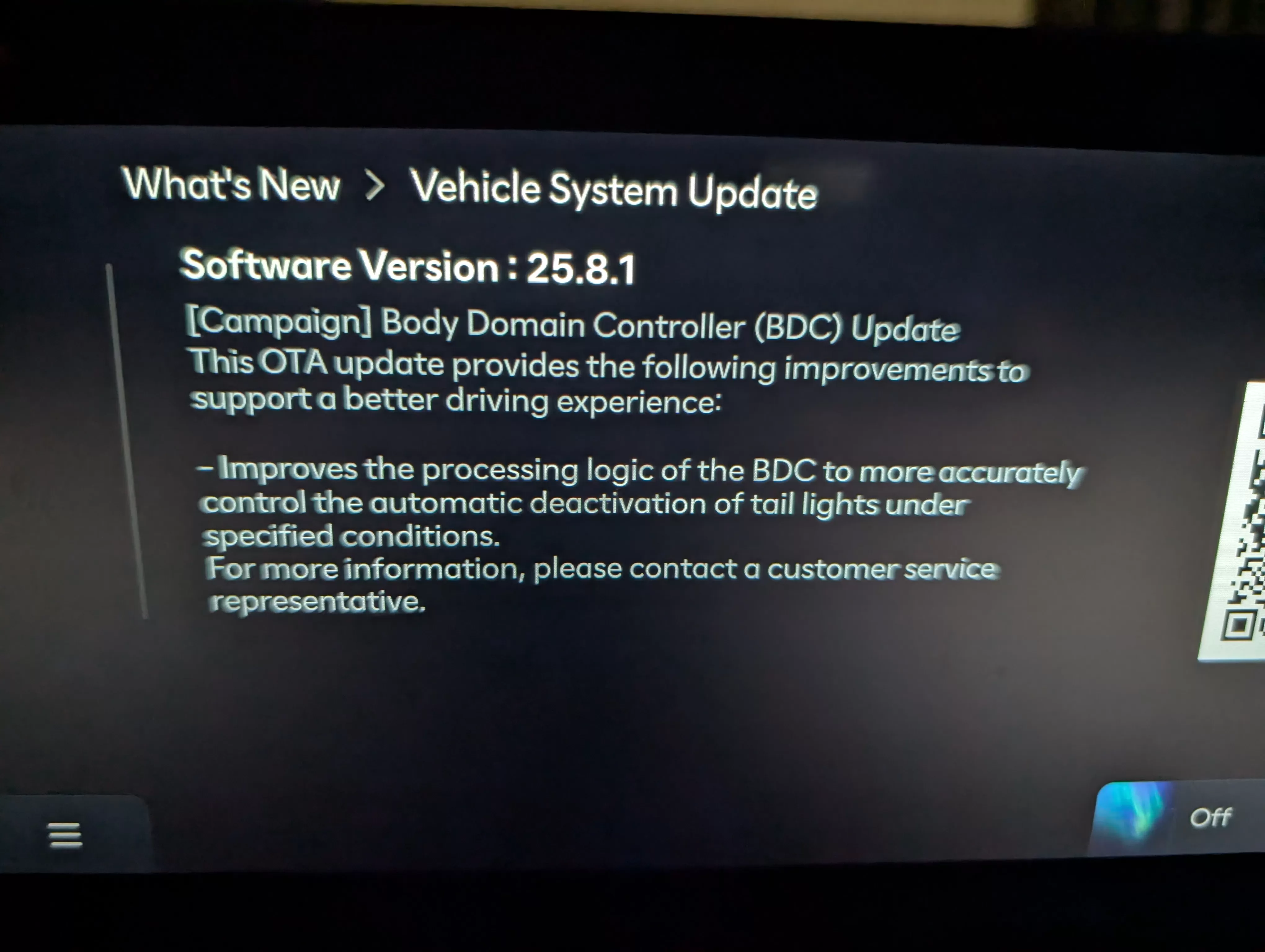

OTA was a success:)
Apparently it is designed to shut off the taillights in a proper fashion after shutdown, here is the TSB:
25-01-044H (scroll down...PDF is downloadable)
I did find out (via BM2) the 12V battery level went down to 12.56 V and did not initiate a top up after the update, or the day after (today).
The usual battery level is over 12.65V at the minimum, so a word to the wise...make sure your battery level is excellent before allowing the downloaded update to be processed. This can be done by rejecting (postponing) the installation until after slipping into utility mode for a couple of hours. There is a mention of the battery level in the TSB concerning OTA updates as well and also keep in mind this update was a small one (just over 3 mb I found out, so a major update could be hard on your battery level if one does not give it a good charge beforehand;)
