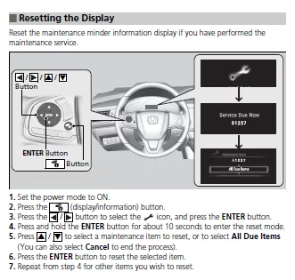

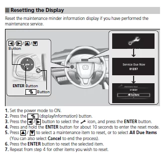

Good discussion all. Would appreciate instructions on resetting Maintenance Minder on the Clarity. Thanks,
Do you have the PDF version of the Clarity Plug-In Hybrid Owners Manual? It's a lot easier to search than the printed manual. Page 479 shows how to do it.
On the console unit, go settings, vehicle, reset maintenance items. You can reset each item individually and before due, rather than dismiss all minders including oil change.
This way, you won't void the engine warranty in case Honda dealers asking for proof of oil change.
I reset tire rotation counter when I got my winter tire. If dealers ask for proof, I can explain that I got new tires, and there is nothing to do with engine oil. Next maintenance time not changed, because I drive little, expecting less than 7500mi per year.
