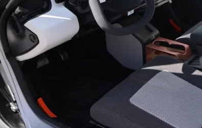

Aptera does have readily accessible interior emergency door releases - and they're pretty difficult to miss: Here's an image of the production-intent vehicle interior - can you spot the release levers?

I knew I'd seen that photo of the emergency door release lever, but, unsurprisingly, couldn't find it before @Kerbe.
