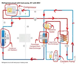

Here's the system layout in heating mode:
There are two separate loops, one with refrigerant and one with coolant.

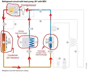

This is the same diagram in cooling mode:

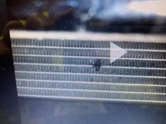

Dealer said "hole in radiator core from a rock" it will take some time to get one. Our cars have two different ones. There is one in Germany and the other one there is none. Guess on cost $1300. No light for low coolant or service. I have the whole car rapped and still rock gets me, bad luck.Please update us on what the dealer says!
Most (all?) modern cars have a coolant level sensor that will show a warning on the dash if the coolant is low so it seems unlikely that it's past the low mark (may be hard to see though).
Yes they did, the rock had to bounce up from the road and into the upper vent of the car. Is it possible? Yes the roads I drive to work there are a lot of truck howling conctruction equipment and metrial. That way i got it rapped.Did they at least send you a photo of the damage?
