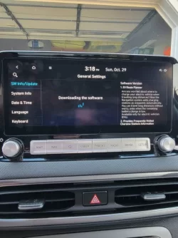

But I get this message that it is downloading something. And in the very upper right, there are the arrows in a circle with a blinking downarrow...20231029_151804.webp
