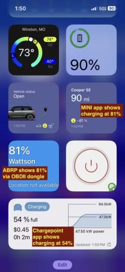

The first image shows that the MINI app and ABRP claim my SE's battery is at 81% while the DCFC I'm plugged into shows the correct SOC of 54%.

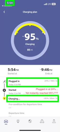

The second image shows the MINI app getting confused shortly after plugging in, showing the correct SOC when I plugged in, yet somehow jumping instantly to a much higher SOC.
