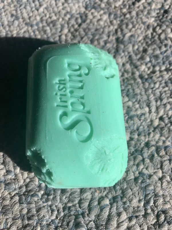

Maybe the spicy tape works better than this deterrent. I don’t know if it ended in death, mild indigestion or just a good cleanse. They did seem to enjoy it.
