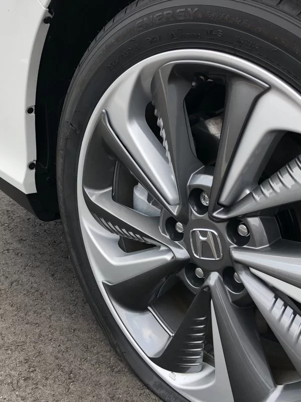

$200 something for the tire, plus at least $100 for mounting and balancing...
It’s slit on the sidewalk. No way the repair kit would fix this.. still waiting for a tow. Supposedly a flat bed is being sent.
So... I stopped right after hitting the curb. So far the TPMS indicator has not detected the flat.
It would only do it if driving? I know it’s “indirect”

From what I read elsewhere here, the TMPS doesn't include a detector inside the tire (for better or worse) but somehow detects it based on a slightly different speed between each side, or something weird like that.
Based on that, then yeah, I think it requires it to roll for a bit.
TPMS on the Honda uses the ABS wheel speed sensor to calculate when a tire is low.

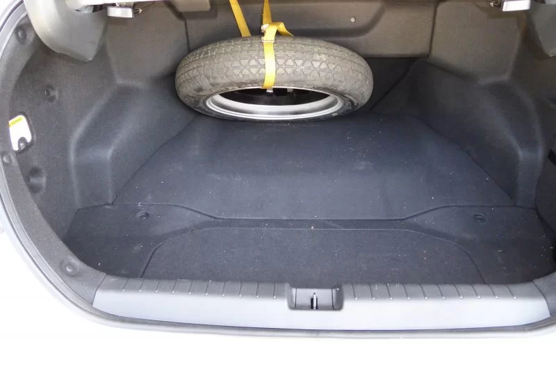

I fully read the owners manual over the past couple days and it had little to no info on spare tire. I never even thought to inquire on this....
So the car doesn't have a spare at all? Is that just a little electric compressor and they expect your flat to be just a small leak and keep it inflated till you can get a plug installed? That would be pretty important info for me, certainly even more so if my wife is out driving.
Correct.No spare. If it's a serious flat you need a tow (by a truck with a platform).
