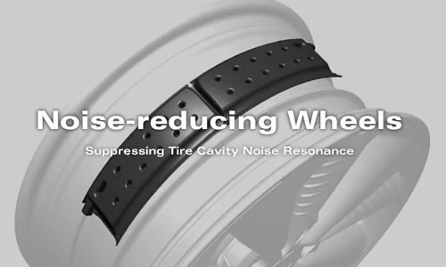

What is a wheel mounted resonator?
It’s a synthetic (plastic/rubber?) part on the inside rim of the wheel that’s supposed to reduce road noice by resonantly cancelling some of that noise out. Whenever you replace the tires or have a tire off for any reason, be sure to warn the mechanic that they are present and can be damaged easily. We have reports that they are not replaceable, so any damage would require a whole new and very expensive wheel.

Unfortunately, unskilled tire-changing mechanics can damage the resonators if they're not careful. Here's what they look like:
I've got a couple of spare wheels. The material is a thin soft plastic (would bend and deform instead of breaking), and reiterate that it would be easily damaged.
