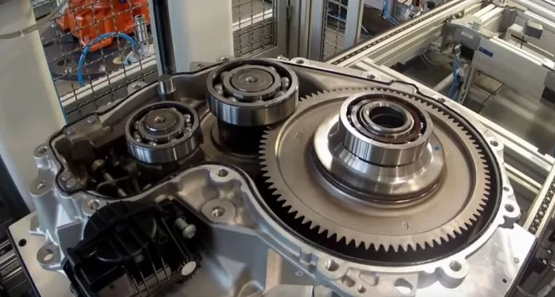

The gearbox is a single speed reduction gear. I didn't see a differential in the i3 e-transmission manufacturing process. Hopefully it's just the e-transmission and not the connection between transmission and electric motor.
Pretty sure that's the differential on the right, it's most likely on the back side of the large gear inside the transmission case.
Maybe! I didn't see any ring and pinions but hopefully someone is kind enough to teardown their e-transmission for science!
