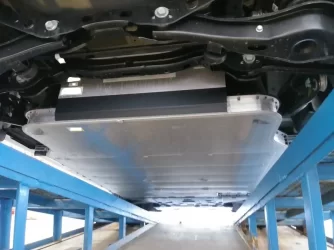

Rear toe is adjustable by manipulating the control arm and lateral link cam bolts independently... if you examine KiwiME's photo you can spot all four cam bolts.
