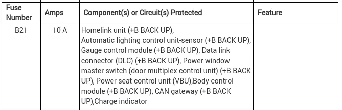

Just for future reference, the fuse that powers the OBD (also known as DLC) connector is in the under-hood fuse box.
Its designation is B21 (shown on this diagram as "21"): It is indeed a 10A fuse.
I find it interesting that this fuse does power quite a lot of functions (consistent with the OP's symptoms):
