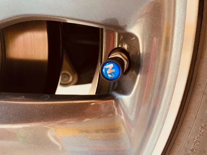

I am curious if anyone else has nitrogen filled tires. I looked all over my paperwork and I did not have to pay for it, but was wondering if this was a dealer thing or they come from the factory this way.
I like the reasons why Nitrogen is put in tires but don't know if I want to go to a dealer and spend $5-7 a tire to fill them up every time I need to adjust the pressure. I have a free O2 station a mile from my house.

Nitrogen fill is port side and usually a dealer installed item. Nitrogen fill in mom n' pop sedans and mini vans is a total waste of time. The air you breath is 79% N...there are no standards for what the dealer will use to fill your tires...conventional theory is up to "93%" N is what will "supposedly" be used. This is just another money making grab by the auto industry.
With that said...putting N in tires is beneficial for high performance cars (ie race cars) only. I suppose if you drive a Porsche or Lamborghini and live in Nevada and drive 110 mph routinely...then N fill in your car is worth it. Definitely not a Kia Niro...unless you live in Nevada and drive 110 mph...lol
The dealerships are setting the stage to charge the consumers $5 per tire to "top it off" during oil change and multi-point inspections. Its not going to be free.
I refused to buy a car with the nitrogen color-coded valve stem. You can put on regular valve stems to remove the "automatic" N fill based on color code. Its that simple.

I should have clarified...its possible some are just caps...so many varieties out there...so double check.
If thats all they are on the Kia Niro...you can buy a set of chrome caps for $4 on Amazon...lol

Thanks to you both for the info. They are just caps on metal stems. I will be using O2 when I need to adjust them and will be getting some new caps. I appreciate it!
Valve stems are the same, it's just the cap telling you what's in the tire. Now why Nitrogen? Firstly, the molecules are larger and thus small leaks are prevented. Secondly, your tires run cooler that just air, thus your tires will last longer. Costco only use Nitrogen and it's free to members. Given a choice only use nitrogen, it makes sense - it is safer also.
