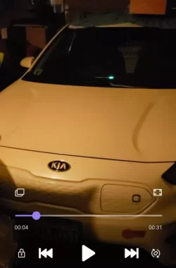

Has anyone noticed their 3rd charge status light blinking at night, while parked and off?
I've encountered this situation 3 times now. The last time was yesterday, Sat at 17:53, while being parked for several days in the garage. No sounds, not plugged it. But the right-hand light, when looking head-on, was on, blinking. And the red security (?) light was blinking, although the car was unlocked. The dash was on, showing the odometer and a half-round in the center. When I opened the driver's door, the charge light turned off and no indications or errors or anything unusual on the dash.
Any ideas?

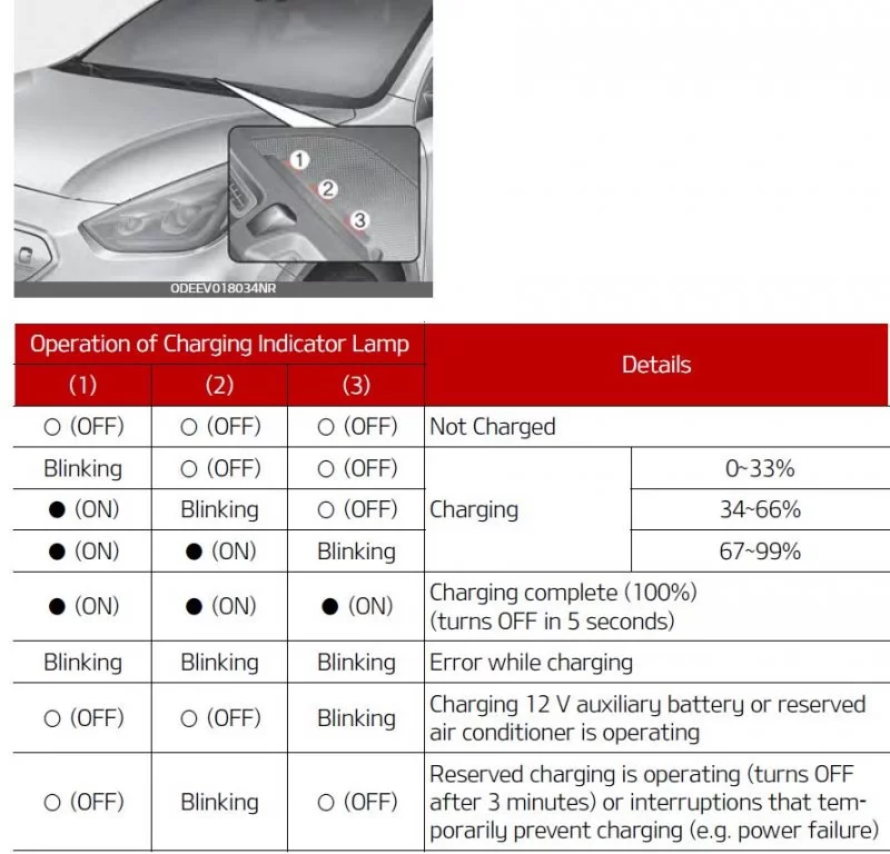

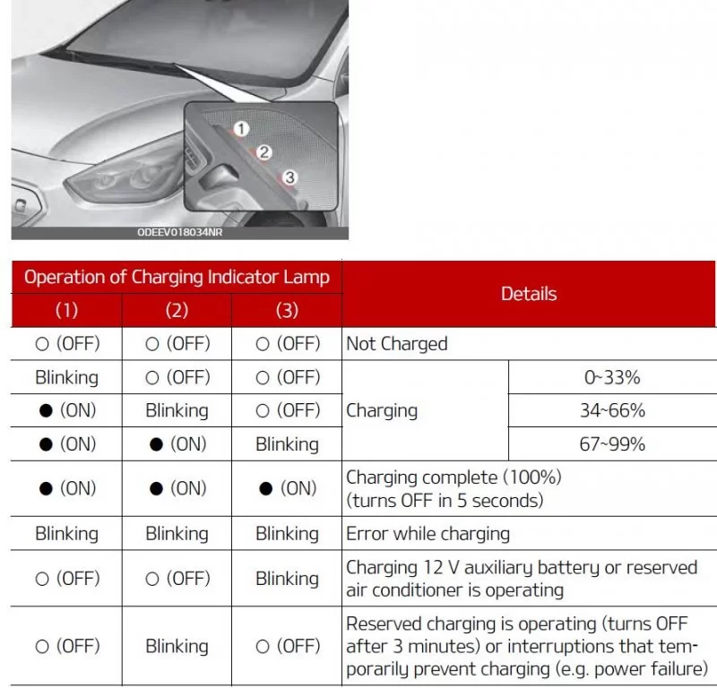

It is tendering the 12V battery (the 3rd charge status light blinking in the indicator).
Amazing what happens when you read the manual. There is a list of several different patterns of the lights and what they mean.
