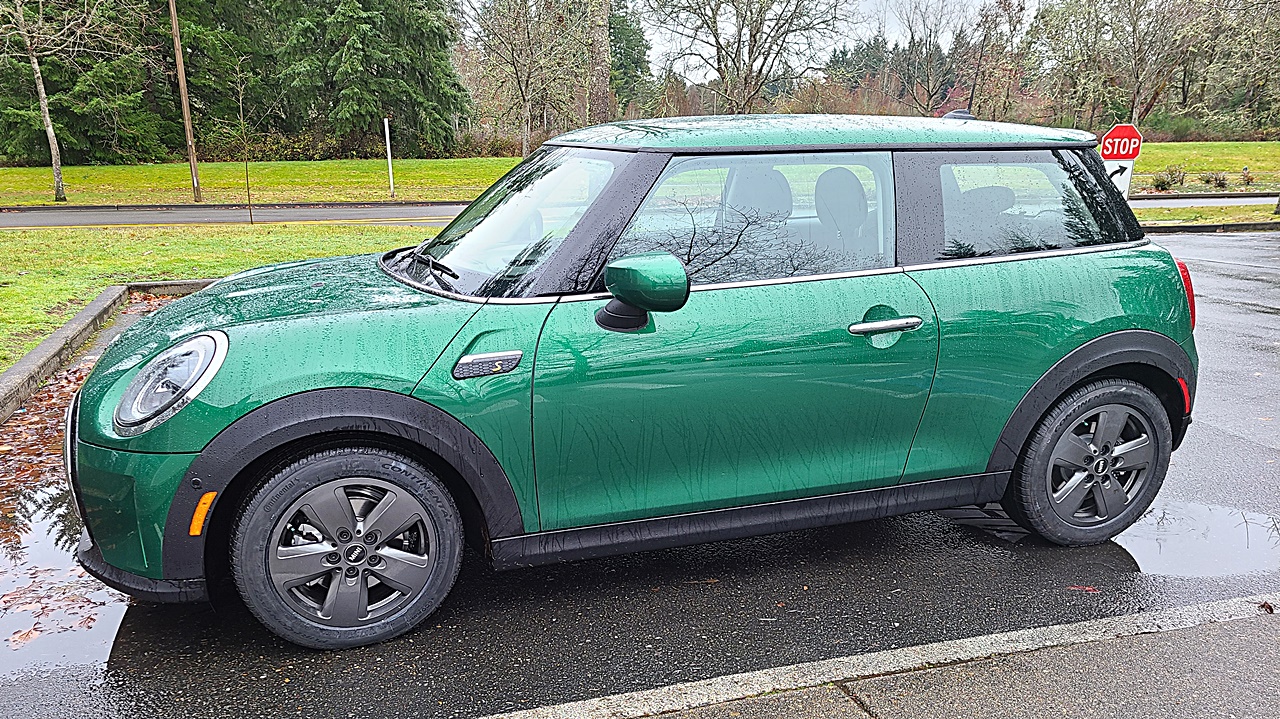

On Monday I got my "new" take-off wheels installed on the Mini with A/S tires for our mild winters.
I bought a set of take-off Mini Revolites that came with Hankook run-flat tires that had terrible reviews and test results for wet and cold weather. Instead, I bought a set of Continental ProContact LS tires which have very good reviews for our NW winter weather type: wet and slightly cold most of the time (30s - 40s often) with just occasional light snow.
Here's how it looks now and for the next 3 or 4 months:

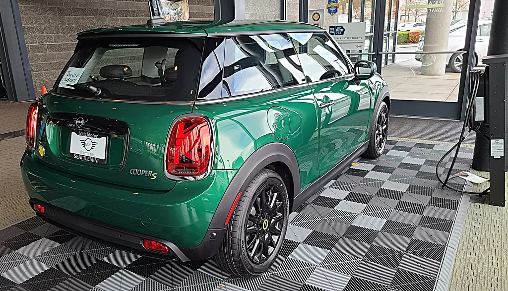

I don't have a good "before" pic that is a full side shot, but here's delivery day:
I do like my black Victory Spoke wheels better so I'm glad they'll be on the car more often.
