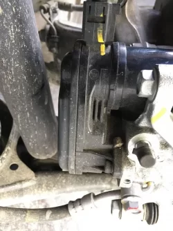

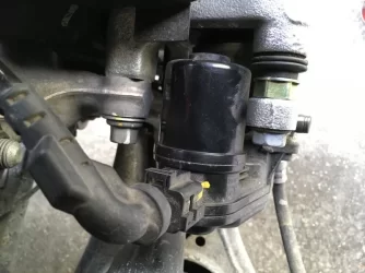

The parking brake actuators are easily accessible with rear wheels removed. They do seem to be somewhat externally protected by the rims but who knows how they are faring at very low temperatures and certainly internally greased components can get sluggish if they haven't used an appropriate grease type.
