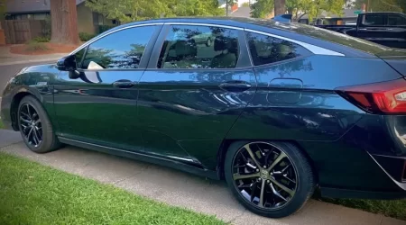

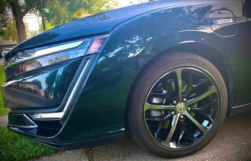

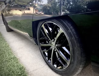

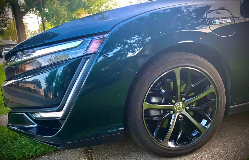

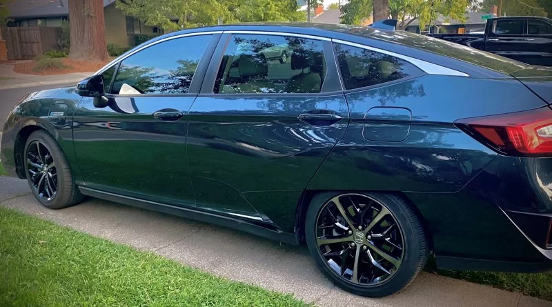

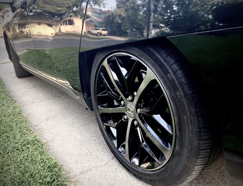

Hi there! Today I picked up a set of virtually new wheels from a 2020 Civic. I’d been looking to replace the original wheels on my 2018 Clarity but really wanted OEM fit. The Civics have identical specs, as do some Accords, and I happened to find this set. Perfect fit, and I think they look amazing. The wheels are much darker than they look in pics, and I like how they look with the tinted windows.
18x8, ET50, 64.1 mm center bore, 5x114.3...exact match between the two cars.

Very nice, what tires are you using and is there a significant ride noise increase with the new rims? I assume the new rims don’t have the dampeners or resonators.
