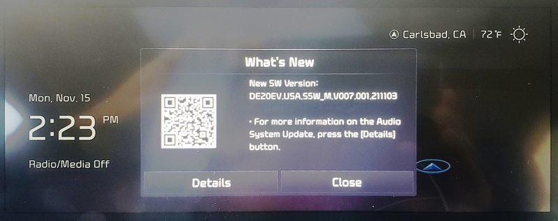

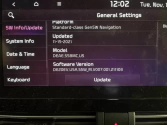

It looks like there is an "audio update" which is separate from the maps update. Do I need to do both updates? Does the audio update allow for wireless Apple carplay on a 2019 Niro EV?
Has anyone done this?
Thanks
Thanks
Wireless car play is a hardware upgrade, new head unit not a software upgrade.
