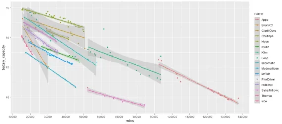

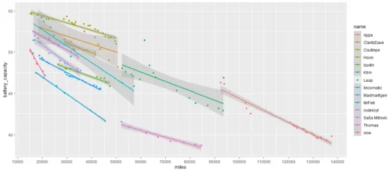

Thanks everyone! I really appreciate the thoughts and perspectives. I've decided not to purchase it. In addition to everyone's thoughts, I figured I'd send along the last piece of info that helped me make the decision.
I took the data that everyone has so kindly contributed and I really roughly estimated how much the battery degrades over time after the initial degradation. I think the lines fit reasonably well for my purposes at least.
When you do the regression on the values in the graph below, i.e. vehicles that had already driven 15,000 miles, it estimates that every additional 10,000 miles driven results in about 1 mAH of degradation. So in my case, starting at 43.6 mAH, if I degrade at 1 mAH per 10,000 miles (or per year for how much I drive), I wouldn't be expected to degrade below 36.6 mAH for 7 years. That's 2 years after the extended warranty would expire.
There's no way to know. So I guess only time will tell, and I'll save up for whatever repairs are necessary when I get there. Thanks everyone!
Why are you expressing battery capacity in mAH’s?

I realize this gets specific, but in my specific case, the ah measurement has gone down consistently 1.5ah/yr. So there may be some flux with that.
I live on a hill and drive / charge the car from zero to full daily. Not sure what all effects battery degradation (but I do a lot of charge cycles from zero to full).
