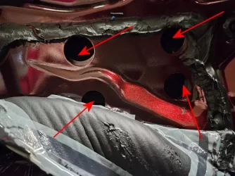

Third was finding the best way to remove the nuts that hold the mirror on. I saw two videos that showed people reaching up from the large lower opening. There was no way that was going to work for me so I started poking at the covering and discovered four holes in the area of the nuts. They are perfectly aligned to remove the nuts. (See picture). The covering is easy to pull down, but expect a lot of gooey crap. Dawn dish-washing soap removes it from your hands.

Four holes for accessing the nuts on the mirror base.
