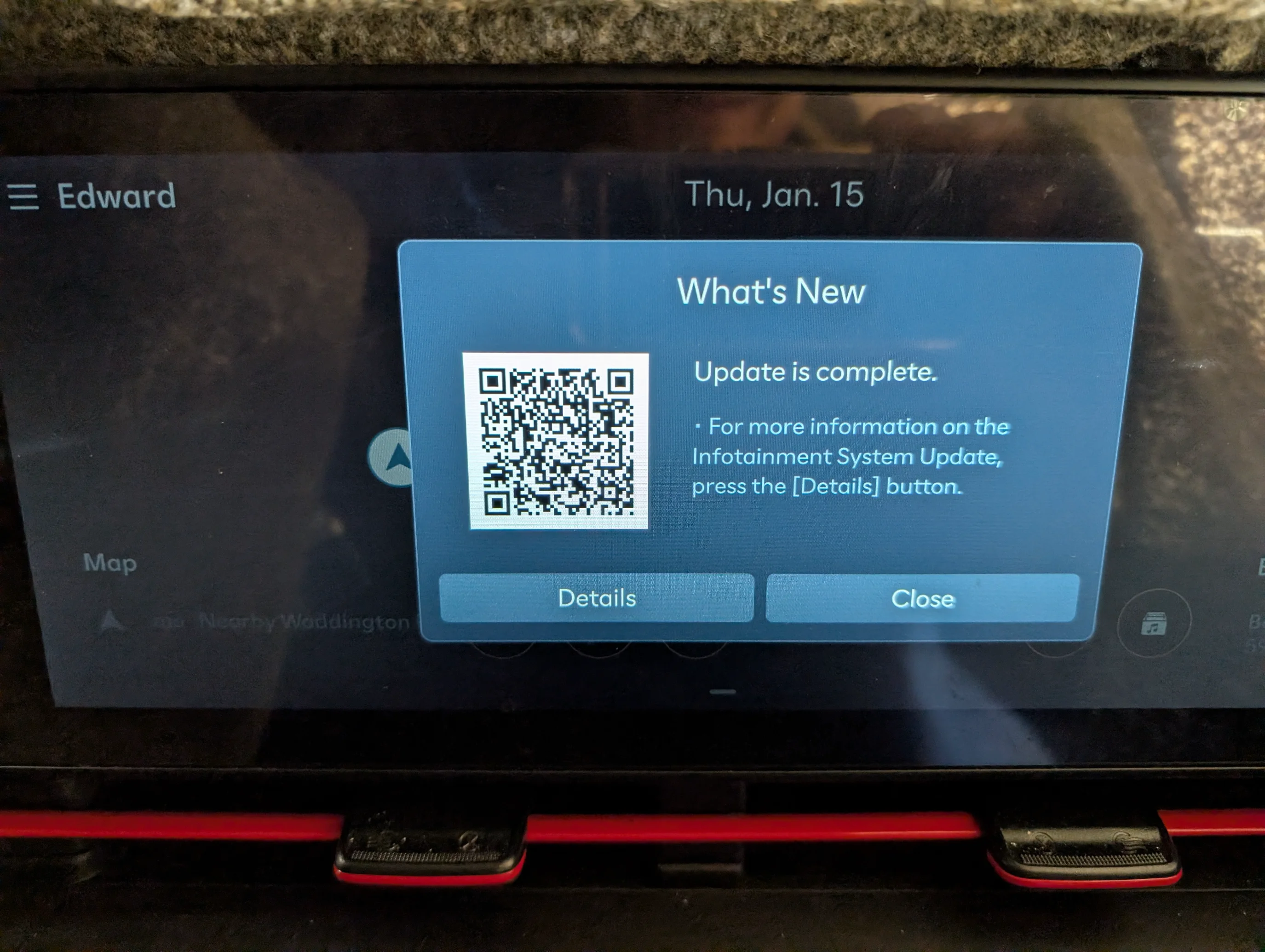

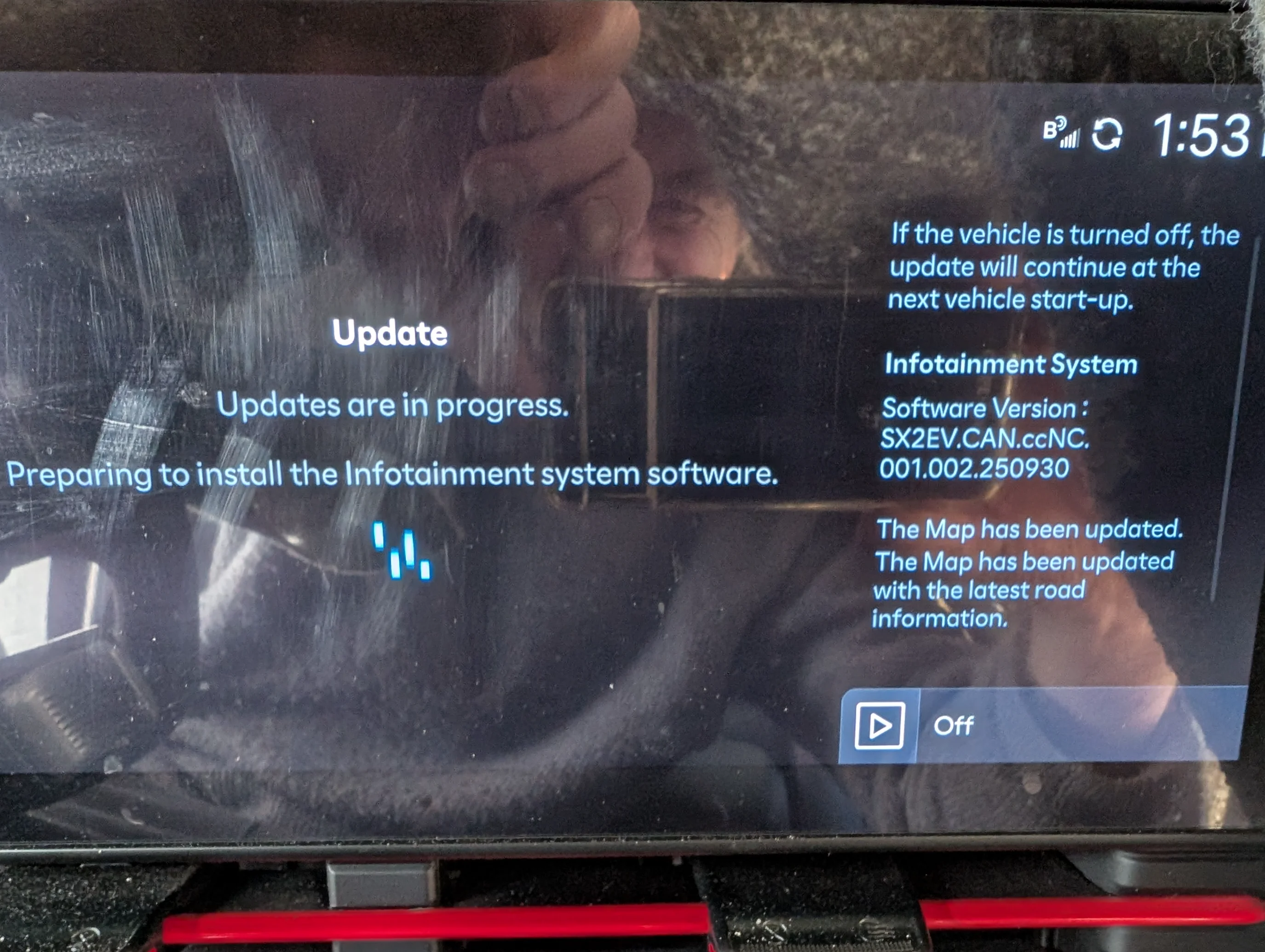

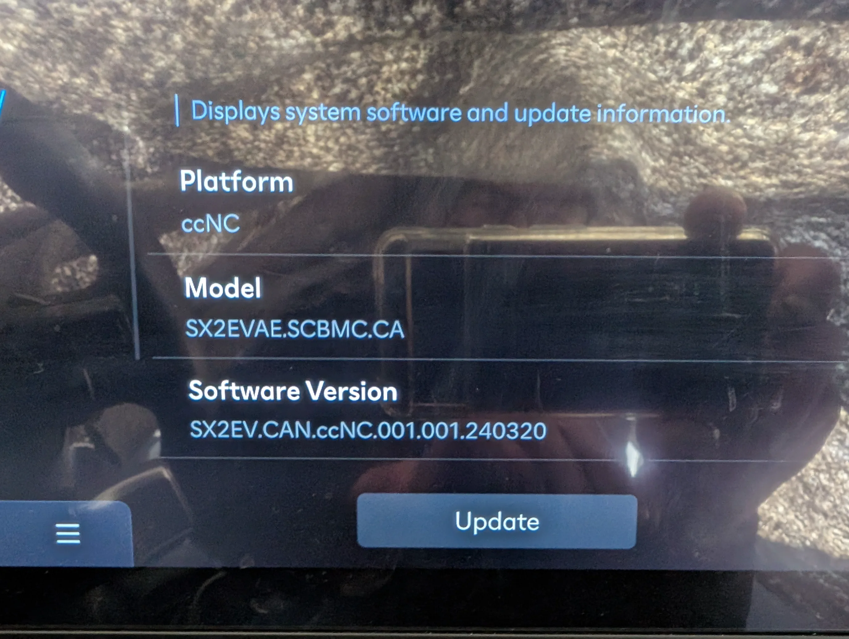

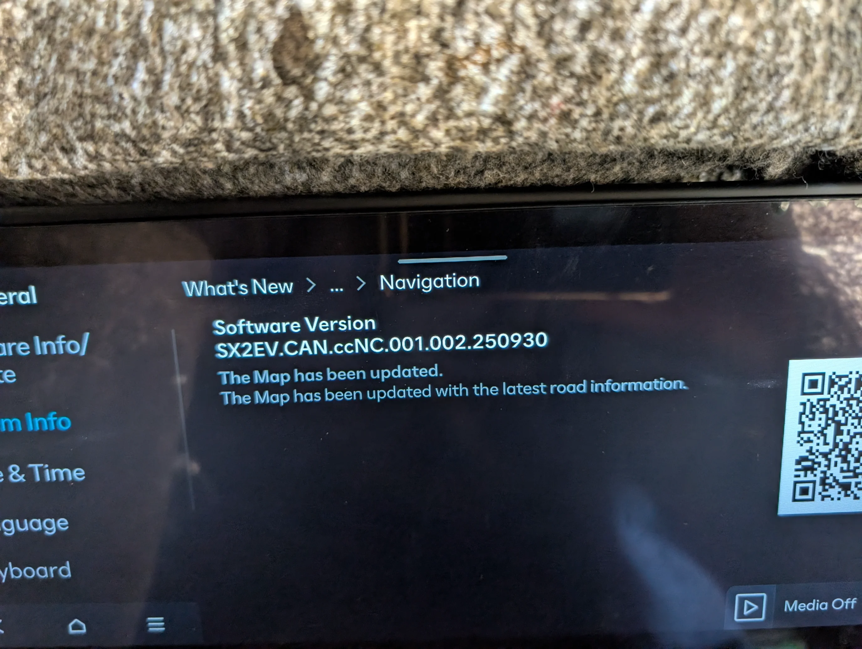

Today, the latest Maps & Nav software have been released. Anyone brave enough perform the UPDATE to your car?
Make sure you delete your previous computer installed Navigation UPDATE Software before starting the process, or it will likely hang forever after the initial download. (Mine did).

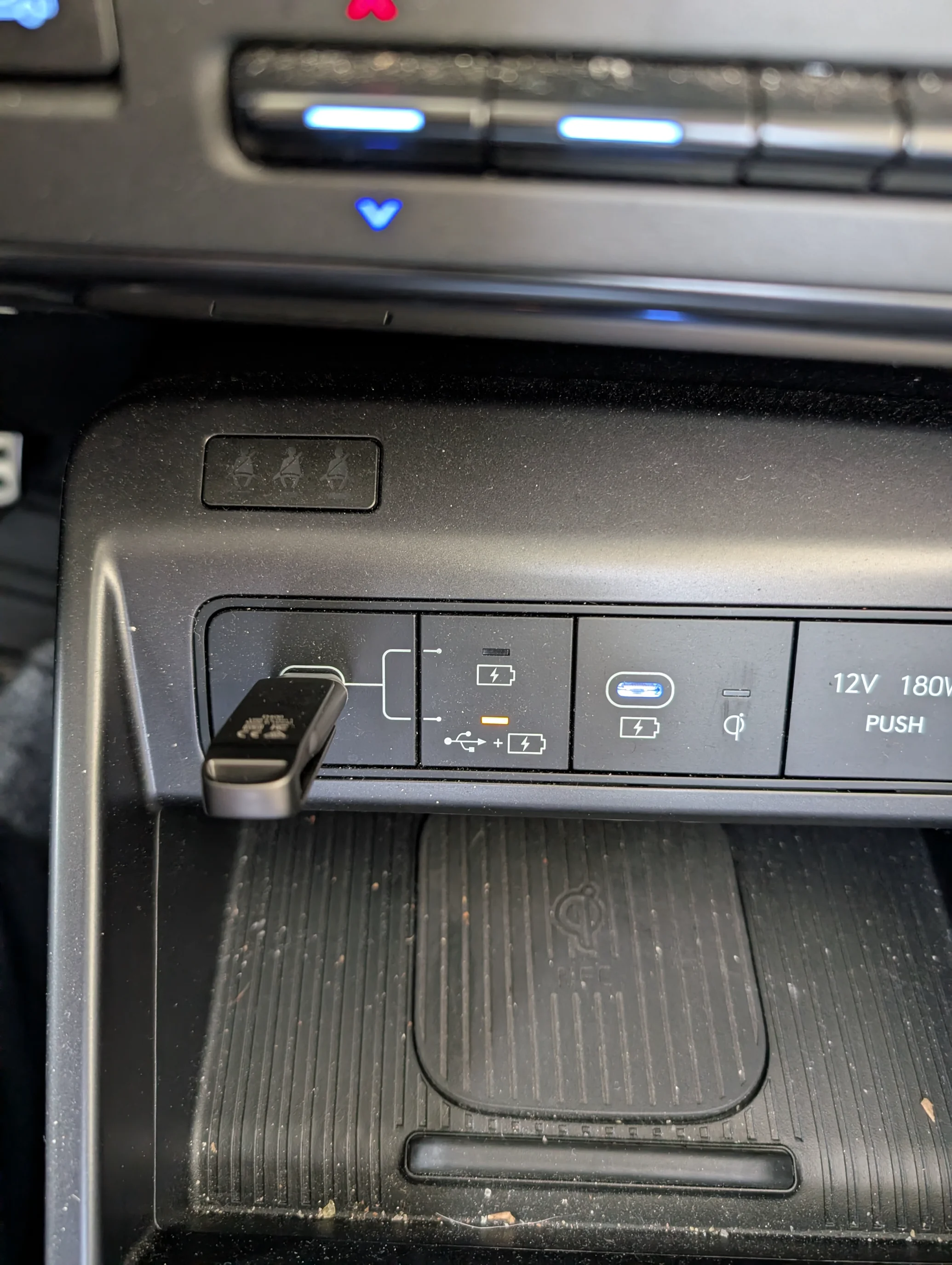

My Update is still on hold. I downloaded with a new thumb drive, put it in my port and it says "no data available". Hyundai tech says I have to take it to my local Hyundai dealership and it will probably cost me $400. Not happy

That's strange. If the update is "available" for your vehicle via the Map Update software based on your VIN, and you were able to go thru the (hours long) download process to your USB, I would expect it to install when inserting in your USB of your car (and clicking Settings / General / Software Update) .... Are you saying you did all that & after selecting the Update in Settings you get that "NO DATA AVAILABLE"? Did you look at he contents of your USB drive to make sure the files were loaded onto the USB ? I think the HYUNDAI response is just the typical ting they say to get $$ from you.
