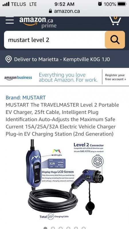

I am looking at the Mustart portable with variable amps and wondering if this is a good product
https://www.amazon.ca/MUSTART-TRAVE...eywords=mustart+level+2&qid=1597885014&sr=8-3

This is a new model unit by Mustart, (not like the others where you can adjust the amperage manually) and requires to purchase a compatible adapting cord/plug specific to the EVSE which will then charge at the maximum rate. (see interlocking pictures at bottom of screen), also note the comments on non CSA compliance or any other approved Canadian accreditation symbol (if you are in Canada). There may be instances where you want less than the maximum charge due to available feeder capacity, or more than "maximum" charge in the case of a 120 volt TT-30 receptacle at a campground (example : 120V*30A =3600W*.8= 2880 W - set for 24 A). I personally would not recommend this unit, and would purchase another as suggested above where you can adjust the amperage MANUALLY (using the shake method or RFID card) also wire in an adapter plug (or second adapter) to convert to different situations available.
Also note Fastnf post about 240 V on the stock EVSE comes with the car, will deliver 2880 W @240V if you just want to charge faster without buying anything except a male 240 v plug such as a 6-15 p would work. (15*240*.8=2880 W)
An adapter can be made (or purchased specific to EV) to convert the 6-15 p to 20 A or 30 A if that is what is available at the receptacle, or for that matter to convert back to 120 V 15 A - (5-15 R) as a standby.

This is the unit I have (almost a year now), and so far it's worked flawlessly. I also have a 100 amp service, but I didn't need a subpanel, just a NEMA 14-50 outlet installed (50 amp breaker). You may have code restrictions that require the subpanel, you should ask. I have the car recharge schedule set to between 12M and 6AM when we're unlikely to use the stove or dryer, and have had no issues overloading the system, even with all AC's running. The portability of this charger appealed to me because with an adapter I can use a dryer outlet at someone else's house if the occasion arose (so far it hasn't). When it was new the plug was a pretty tight fit, but after a few uses it loosened up and it's pretty easy now. If you choose this you'll be happy with it.
