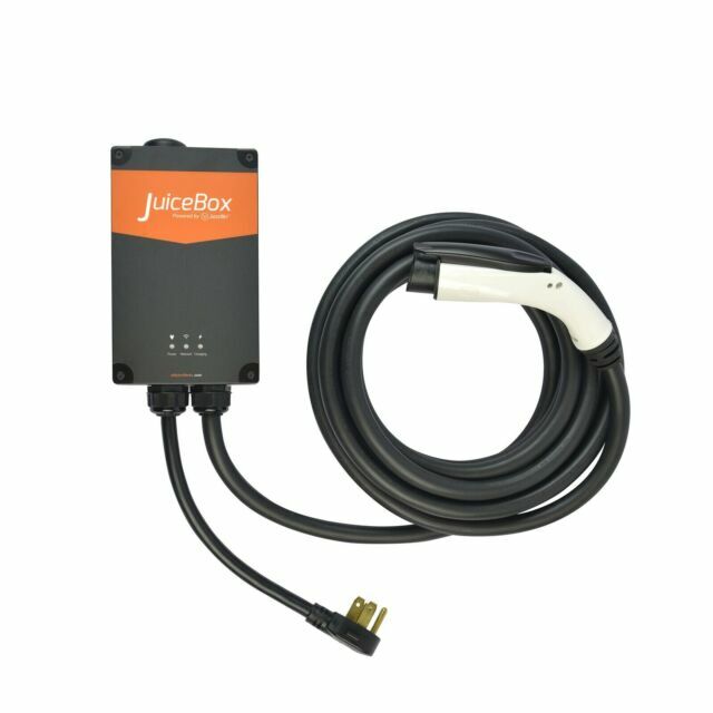

That's what I did, got a charge point charger that plugs into drier plug in garage and it's great.

It's in a small metal box, I put a longer cable to the clothes dryer plug. Very portable.
