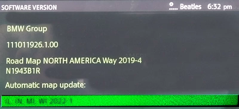

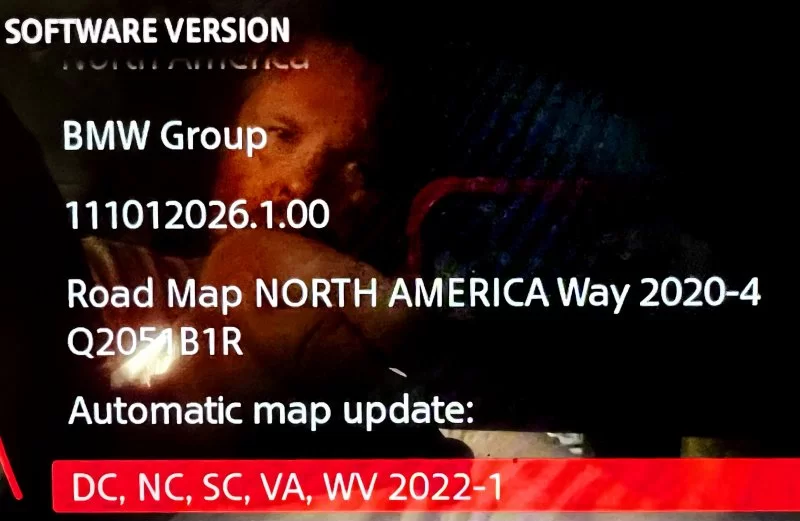

Do you know how you check to see if you have the latest map installed?
  1. Navigation
  2. Settings
  3. Position and software version
  4. Software version
Took me to this screen:
I had to up the contrast for the info in the Automatic map update: IL IN MI WI 2022-1
If I want to go south to Ohio, I'm on my own, update-wise (but people from Ann Arbor don't like going to Ohio anyway). It appears I don't get updates for @Carsten Haase's street (and neither does he).

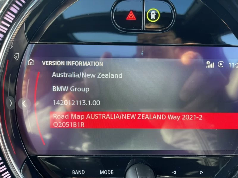

Here in NZ, we do not have OTA updates, our map updates are via USB, we go to the mini-connected.co.nz, enter our credentials (same as the one you used to login on the MINI app, then go to USB Update. This will ask you to load your VIN and for a USB with no files, then it will proceed to load the files into the USB, which you will plug into the SE when you update the map.
Here is how the (NZ) map version looks like, noting there is no notice of automatic update.
The map once directed us to a cul-de-sac, which I know was wrong bec the house was not there, so we went back to the street corner and re-entered the same address and we followed the new route and arrived at the house. Then I realise that the cul-de-sac was behind the correct house; so was the MINI seeing a supposedly straight road from the cul-de-sac to the house? [emoji23]
