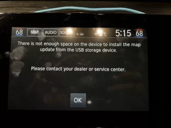

I just tried to install the latest map update from garmin and got a message that there is not enough space on the device to install the update. Has anyone else seen this error?
Argh - I don't like the looks of that.
One random thought - What size is your USB drive?
Perhaps the installation process requires some extra space on the USB drive (beyond just what the update itself uses) for temporary files, etc.
If you have a larger USB device you could try that. Or, if it is clear that it has lots of free space, then this is a dumb thought.
The update used about 50% of the space on the usb - 15gb out of 32 gb. I’ll be calling the dealer next week to see what’s going on. Given the level of dealer knowledge on the clarity I don’t have a huge degree of confidence. This is (I think) the same units that’s in the 2016 accords so maybe they will have some idea of what’s going on.

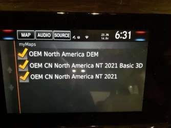

I am a user of the built-in navigation. I have updated my maps several times, and I beleive it is 'current'?
Here is a screenshot of my version:
I have not encountered the problem that you had, but If my version is not current, I am willing to try an update to see if I have the same trouble...
I’m getting the same error message on my wife’s CRV so I’m guessing this is a garmin problem. I’m looking forward to lots of finger pointing between garmin and Honda to try to get this resolved.
I don't know which would be easier to deal with but my suspicion is that the ball is really in Garmin's court. I wonder if it would make sense to start a dialog with them? If I have a chance, I'll check for updates and try this on my car.
I got a reply from garmin support overnight and will give it a shot. I’ve updated my maps for years using the same 32 gb usb stick, but will give it a shot with their suggestion. Now I just need to track down a 16 gb usb somewhere!
reply from garmin support:
The Honda Navigation System update requires a 16GB USB flash drive. Using a USB flash drive smaller or larger than 16GB can cause the map update process to be unsuccessful. The following error message may display: "There is not enough space on the device to install the map update from USB storage device."

This happened to me too; I "think" what I did was to DELETE the map(s) on the Garmin using the car display..
but don't quote me :-) was using a 32GB key - but notice that I have last used (successfully Dec 4/21) a 16GB key - so maybe that IS the right answer... easiest anyhow! Good luck John

I just installed the update, and it worked just fine. The map versions now show 2022.

I was successful with a 16gb usb drive. I’ve used my 32gb for a few years now, but this time I guess the navigation is finicky! I’ll take the win at 16gb using my new $6 usb drive on sale at staples.
