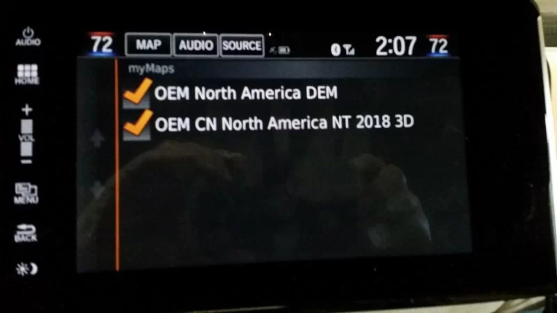

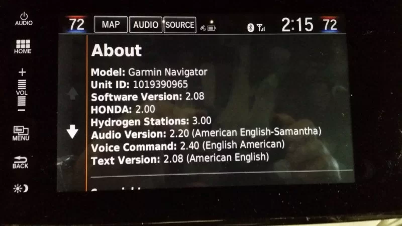

I found another Navigation issue over the weekend: An important major (long time existing) public road in my town (containing many businesses and restaurants) does not exist in the Garmin maps. I have an email into Garmin. Meanwhile, I'm using Android Auto and Google Maps.
HELP: I'm trying to debug my navigation problem (no major public road detail in my town, as mentioned in my
as shown in my post above.) I did the map update a few months ago and the attached files show the map versions in my Clarity. Am I missing a map in my Maps? Thanks
