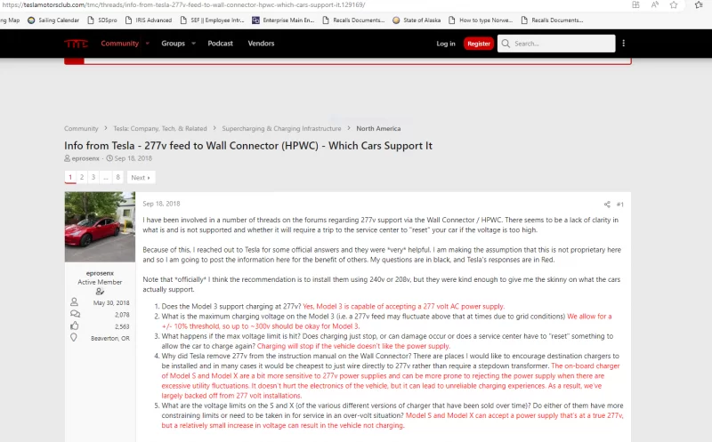

Attached screen snip shows Tesla answering questions about charging with 277 volt

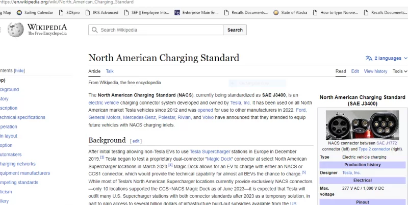

And also attached Wikipedia shows NACS "standard" in the lower right to support 277 volt

I'm only thinking of AC charging, and it looks like originally Tesla was allowing 277 volts on the NACS, but shied away from it as time passed. Probably modifying any chargers they installed away from the 277 in favor of the 240.
