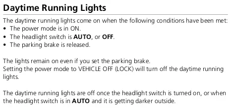

I was thinking the DRL's were always on in the US too.
From the manual, it looks like they are always on except when the headlights are on...
Are you saying that in Canada, the DRL's stay on even when the headlights are on?
Excerpt from the manual:
