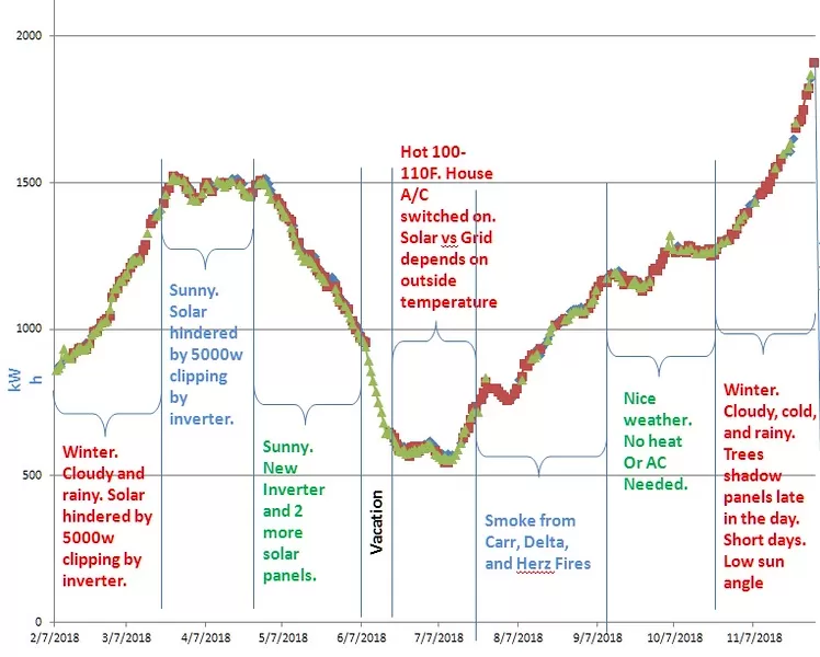

The solar installer underestimated the capacity of the panels we selected and installed an under-powered inverter which was clipping at 5kW. That was corrected but we lost some potential power generation for three months.
We also had heavy smoke from the huge Carr fire for six weeks. Not only did the smoke partially block the sun, it also coated the solar panels. I had to wash them three times.
I was disappointed to notice late afternoon shade on the solar panels this week. We have two 50 foot and growing redwood trees that catch the low angle sun. The cost of topping those trees would never be returned in solar savings. Most of the year the sun is high enough so those trees aren't a problem.
The dramatic swings in power generation from the roof solar surprise me. Peak power is about 52kW per day midsummer when the days are long and the sun is high in the sky. A full sun day in December might produce 20kW. We've had days of near zero production when there is full overcast and rain. Surprisingly the system always manages some watts even on the worst days.
This chart shows grid power readings from our electric meter (net metering). Up slope means the solar system needed more help from the grid. Down slope means we were feeding power to the grid. We balance with the electric company once a year.
